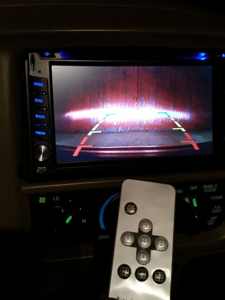

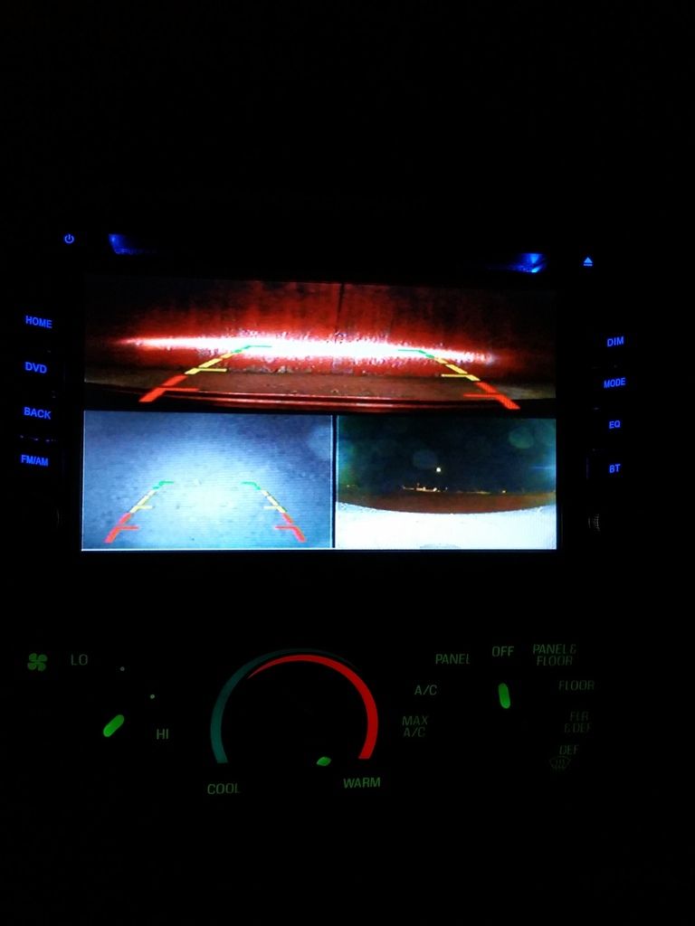

Re: What's behind your boat?
Postby JP » Fri Feb 17, 2017 2:05 am
I spent the better part of 4 hours wiring these into the truck. I'm using 3 cameras and one monitor. One back cam for getting the trailer on the truck and another on the back for wide view and one cam on the front. When I installed the stereo the first time I used the cam and wireless set up to link the cam to the monitor. If you have a long truck like mine I do not recommend using the wireless connection. The camera would not come on and when it did the pic was fuzzy. Since I hard wired them I have no issues at all. I put all camera's and the video switch on switched power. This way they only come on when I have the monitor switched to camera view.
1996 Interceptor 232 sc
2001 F-150 SD
JP
Posts: 72
Joined: Mon Jun 04, 2012 7:31 pm
Location: Colorado!!
Postby JP » Fri Feb 17, 2017 2:36 am
With the video switch I can view 1-4 cameras at once or a combination of 2 or 3. The switch came with a remote to make that process a bit better when driving. Sorry bout the dark photos. When I finally finished it was dark out and those were taken in front of my barn and back to the road. Once I get a trailer behind the truck I will let you know how the process of being able to move a camera to the trailer worked. Once spring set's in I'm going to make some changes to the boat with camera's. They have a video recorder that you can install with the switch and cameras. Thus way I can use the tv that's in the boat and be ableto record people wake boarding, skiing and tubing. I'm sure the kids will get a kick being able to watch what they were doing. Also this kind of stuff helps catch people trying to steal your stuff when your not anywhere around. It is nice to update the truck with new technology. The stereo also has navigation, DVD, BT, and a bunch more stuff. I didn't have to give my arm and leg for this stuff also. Some cameras are as little as 10 bucks on amazon. Prob the most expensive part of it besides the stereo was the video switch. This was a fun project that did not take very long at all and the benefits are great.
